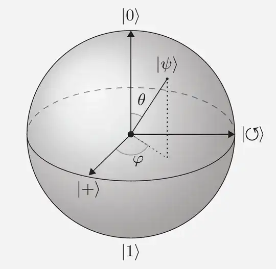

For this, we need to take a Bayesian approach. If we don't know the state, we assign a probability to each of the possible states. In that case, the expected fidelity of the transformation is $\bar F$, the maximum eigenvalue of the operator $$ R=\sum_{\psi}p_{\psi}|\psi\rangle\langle\psi|^\star\otimes(|\psi\rangle\langle\psi|\otimes\mathbb{I}+\mathbb{I}\otimes|\psi\rangle\langle\psi|) $$ You might know something about the possible input state. For example, if you know it's either $|0\rangle$ or $|1\rangle$ with equal probability, you still find the maximum eigenvalue of 1 (which makes sense: you can measure the input state in the Z basis and make as many copies as you want). At the other extreme, if you know nothing about the state at all, you have to average over all single-qubit pure states with equal weights. What is the right way to do this? It's a bit messy as you can perhaps see from looking at the Bloch sphere: enter image description here We need to take an average of all points on the surface of the sphere.
One way to achieve this is to say that every $|\psi\rangle=U|0\rangle$ for some $U$, and we average over all possible unitaries, where the correct averaging is determined by the Haar measure. So, we can change our operator $R$ into $$ R=\int U^\star\otimes U\otimes U\left(|0\rangle\langle0|^\star\otimes(|0\rangle\langle0|\otimes\mathbb{I}+\mathbb{I}\otimes|0\rangle\langle0|)\right)U^T\otimes U^\dagger\otimes U^\dagger dU $$ This is basically the twirling operation (except for the slight technicality that there's a complex conjugate on one of the qubits), and certainly captures the intuition of how/why it comes into things.
