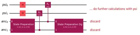

I want to remove the ancilla qubits from my quantum circuit in Qiskit. My MWE below contains four qubits: psi0, psi1, anc0, anc1. I want to keep psi0 and psi1 qubits and remove ancillas anc0, anc1. Is there a way to do this?
from qiskit import QuantumRegister, QuantumCircuit, AncillaRegister, transpile
from qiskit_aer import StatevectorSimulator
import numpy as np
reg1 = QuantumRegister(2, 'psi') reg2 = AncillaRegister(2, 'anc') circ = QuantumCircuit(reg1, reg2) circ.h(reg1[0]) circ.h(reg1[1]) circ.prepare_state(1/np.sqrt(2)np.array([1,0,0,1]),reg2) circ.cry(np.pi/2.2, control_qubit=reg2[1], target_qubit=reg1[1]) circ.cry(np.pi/1.5, control_qubit=reg2[0], target_qubit=reg1[0]) circ.prepare_state(1/np.sqrt(2)np.array([1,0,0,1]),reg2).inverse()
simulator = StatevectorSimulator() job = transpile(circ, simulator) # execute circuit on qasm simulator result = simulator.run(job,shots=128).result() # results from the job out_state = result.get_statevector() print(out_state)
circ.draw('mpl')
I'm aware of a function that removes idle wires, but it loses the register's info. Is there a different function that specifically removes ancilla qubits (and keeps the register's info)?
Edit: Provided clearer circuit example. To clarify: Yes it will be ok to keep the ancilla qubits until the end of the circuit. I just need psi qubits in the next part of the calculation. I want to do a statevector simulation of psi, not anc, at the end. Ideally I don't want to initialize a separate circuit using the output density matrix -- I prefer to use one self-contained circuit.

As I mentioned in the comments, if your psi qubits are getting entangled with the anc qubits, there is no way to recover a Statevector just for psi because the state will not be pure.
Instead, what you can extract is the density matrix of psi by tracing out the anc register. That being said, if the anc qubits are properly untentangled from psi you can always convert that DensityMatrix object back into a Statevector object.

By the way, the circuit you provided as an example is of the second kind: psi and anc are entangled, so psi is not a pure state.
