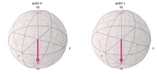

By running statevector_simulator, I can see a representation of the 2 qubits on Bloch Sphere, and I can also try getting some samples to see the expected outcomes.
The thing is when I run the following code, I can get some results where qubit0 is pointing to |1> on Bloch Sphere, however in the histogram plot the results doesn't show an outcome where qubit0 outcome is |1>. I also noticed that qiskit uses little indian format so results are formatted as "q1q0", unless I got the wrong idea about this?

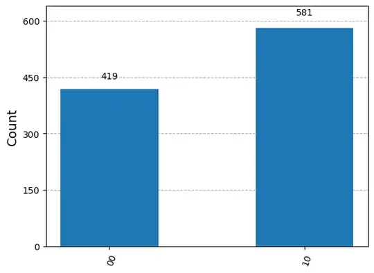

And here is the histogram plot, as you can see here there is no |1,1> results. But the Bloch Sphere image shows the 2 qubits in |1,1> state.

While writing this question it came to my mind that there is no |1,1> in the results because of how I measured the qubits, and I now assume even when using circuit.measure([0, 1], [1, 1]) the statevector returned from statevector = result.get_statevector() will still return the result for qubit0, however it won't be returned in counts = result.get_counts() since we save both qubits in classical bit 1.

This code did not change the results format, where output counts where still '00' and '10', So I also assume that there is no effect on results when measuring qubit before another in the circuit? Unless there is something going on that I did not understand and I have absolotly a wrong idea about quantum so far?

The reason you see different results between counts and the statevector_simulator simulation is because the counts are the result stored in the classical register, whereas the Statevector is the state of the quantum register.

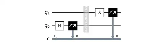

Here's a simple example. Consider the following circuit: enter image description here
First, $q_0$ is placed in a superposition of $|0\rangle$ and $|1 \rangle$ and measured. This projects the state of $q_0$ to either $|0\rangle$ or $|1\rangle$, and the corresponding value of either 0 or 1 is stored in $c_0$.
Then, $q_1$ is inverted to state $|1\rangle$ and measured. It's value is stored in $c_0$, overwriting the result of $q_0$.
This means you always get a 1 in $c_0$, but the Statevector for the qubits could be either $|10\rangle$ or $|11\rangle$, which is what the statevector simulator will show.
