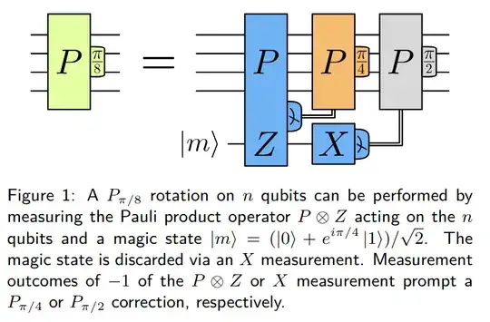

In Magic State Distillation: Not as Costly as You Think,
Shows that a $P_\frac{\pi}{8}$ gate can per done on $n$ qubits using 1 magic state. When I simulate this circuit though, it doesn't seem to provide the correct output.

We then simulate the circuit from Figure 1 of the "Not as Costly as you think paper"
0: ───H───────M(Z)────S────────────Z───────T───T───T───H───M───
1: ───H───────M(Z)────╫S───────────╫Z──────T───T───T───H───M───
2: ───H───────M(Z)────╫╫S──────────╫╫Z─────T───T───T───H───M───
3: ───H───────M(Z)────╫╫╫S─────────╫╫╫Z────T───T───T───H───M───
4: ───H───T───M(Z)────╫╫╫╫M(X)─────╫╫╫╫────────────────────────
a: ═══════════@═══════^^^^╬════════╬╬╬╬════════════════════════
b: ═══════════════════════@════════^^^^════════════════════════
This one does not give the same counts, which makes me suspect that the T gate is not being implemented correctly.

What's going on? Am I reading gate teleporation figures incorrectly again?

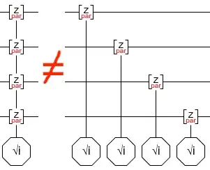

The gate that you are applying by teleportation is $(Z^{\otimes 4})^{1/4}$. This is different from $(Z^{1/4})^{\otimes 4} = T^{\otimes 4}$. For example, $(Z^{\otimes 4})^{1/4}$ doesn't phase the $|1100\rangle$ state whereas $(Z^{1/4})^{\otimes 4}$ phases it by 90 degrees.
Here's a quirk circuit with the two gates, so you can see they do different things.
