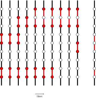

Syndrome matching
Vertices are stabilizer measurements, red vertices correspond to the syndrome, lines are potential qubit errors. The matching is in red, with $25$ deduced qubit errors, most of which cancel each other since Pauli errors are Hermitian operators.
The column on the left indicates the sum modulo 2 of the qubit errors.
The deduced correction is exactly array([0, 0, 0, 0, 1, 1, 0, 0, 1, 0], dtype=uint8).
