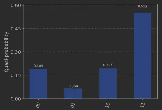

The second question is related to the result ration of the output vector $\vec{x}$. What the authors write about $\vec{x}$ is that
ratio of $|x_0|^2$ to $|x_1|^2$ is $1:9$.
however the output results show the different ratio: $0.142^2 : 0.361^2 = 1 : 2.54$
The question is resonable: what does the measured ration mean and how to make outcome to be more "true"?

the results are the same as in the paper:
The difference between what you have and what is in the paper is that you are calculating the matrix $U = e^{iA}$, and in the paper they calculate: $ U = e^{iAt},$ with $t=3\pi/4$.
The reason they do this is because they already know what the solution is going to be, so they are basically rescaling the matrix $A$ to given them "nicer" eigenvalues that allow them to cheat in the implementation of the eigenvalue inversion step.
As for why your solution is not giving the 1:9 ratio, it could be that if you are using the same angles as used in the paper for the eigenvalue inversion step but your matrix is $U = e^{iA}$, then your result is obviously going to be incorrect because you haven't accounted for the $3\pi/4$ scaling for the angles.
