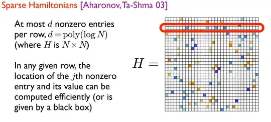

If you prefer a visual, you have it here:

I believe the way they use it is as
The maximum number of non-zero elements in any row.
Although that’s different to the way Wikipedia defines sparsity, which is essentially the average:
the total number of non-zero elements divided by the number of elements.
