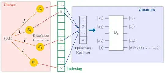

Following figure is an attempt to represent the Grover's algorithm, definitely lying on the Quantum side, with respect to the database itself, which lies in the Classic world. In between is the database elements indexing, each element of the database is assigned an index, regardless of its inner position in the database. Each index is encoded in the quantum register.
Grover oracle and classic function
On the Classic side, you can build a function $f$ with your particular DNA trace $T$, which takes in input a database element $E$, and returns $1$ if $T$ and $E$ are identical, i.e. belonging to the same person, or $0$ otherwise.
Oracle $O_{f}$ performs the evolution :
\begin{equation} |y\rangle = |- \rangle \quad,\quad O_{f}(|\psi_{H}\rangle \otimes|y\rangle) = \frac{1}{\sqrt{N}} \sum_{k=0}^{N-1}|k\rangle \otimes|y \oplus f(k) \rangle = \dots = \biggl(\frac{1}{\sqrt{N}}\sum_{k=0}^{N-1}(-1)^{f(k)}|k\rangle \biggr)\otimes|- \rangle \end{equation}
which means that previous function $f$ is applied to each fundamental state of the superimposed state $|\psi_{H}\rangle$. But then, this means we would have to call the classic function $f$ for all indices and consequently for all database elements, which would make useless the quantum algorithm ?
How do you concretely implements the oracle in such real life use cases ?

Well, I'd start by debating your assertion that there's no way to sort DNA fingerprints. Any data that you have is written in some language, and you can sort it according to the lexicographic ordering of the alphabet you've used. (Searching for a 99% match might be a completely different matter!)
Nevertheless, if we take your proposal at face value, I think you have a basic misunderstanding of how we count the running cost in terms of oracle evaluations. Yes, the oracle, in some sense, gets evaluated for all possible inputs. But it does not do this one after the other. Each branch of the superposition only interrogates the oracle once. Hence, each branch takes the same time, and the total time is the time for one oracle call (for this single step. You will then have to repeat the step many times to complete the search).
