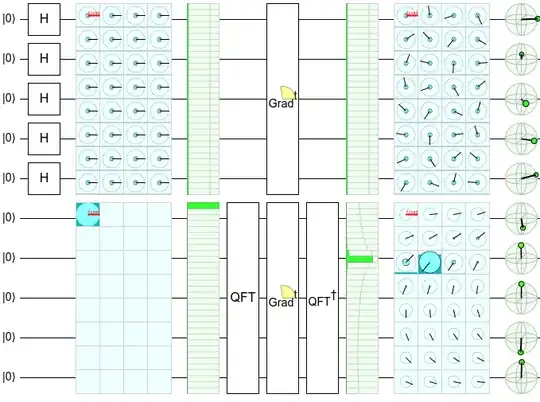

When you conjugate a phase gradient with Fourier transforms, you get the offset operation $|k\rangle \rightarrow |k+x \pmod{2^n}\rangle$ where $x$ increases as the strength of the gradient increases. This relationship is a well known property in signal processing (shifts in the time domain become phase gradients in the frequency domain, and vice versa). It's also the key insight behind Draper's QFT adder.
