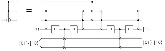

You can exactly implement a Toffoli using CSWAPs catalyzed by a singlet state:
The singlet state is the -1 eigenstate of the swap gate, and you can get phase kickback from a swap by using cswap, so you can create the catalyst by postselection:
There's probably some simpler way to do this, but this proves it's possible to do exactly.
I'm interested in only the 3-qubit case without the use of ancillas or encoded (approximate) universality.
Oh. Well that's harder. You're sure you don't want to just be able to do the gate exactly with 7 CSWAPs, instead of doing it approximately with presumably hundreds or thousands of CSWAPs?
