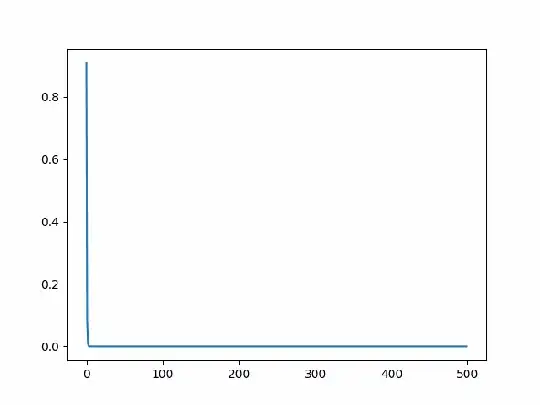

I have run the simulation where the heating lasts for heating_time = 5e-3 (5ms), which means the number of phonons increased should be approximately heating_rate times heating time ~= 5. However, If I run the simulation and get the expectation value of phonons after the heating (motion_data.expect[0][-1] part), I get 155.
Below is the gif that shows the change of phonon probability distribution of above simulation: enter image description here
where Y axis is the probability value and X axis is the harmonic state (n) of phonon up to dim=500. At the very last of the simulation, there is an instantaneous spike at n~= 500, which seems wrong.
Is there anything I did wrong with my code? I assume modifying the defined hamiltonian could be one way of fixing this anomaly, but I'm not sure. Please help :(
Thank you all for the comments. I think I have solved the issue by adding a conjugate heating term, jump_heat_conj = np.sqrt(heating_rate)*tensor(qeye(2), destroy(max_N)).
