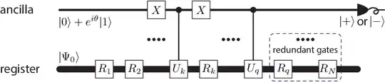

From this we can get the time derivative of the parameters by calculating the A-matrix and C-vector. The elements of these can be measured by quantum circuits, like this one for the elements of the A matrix:
Quantum circuit for the evaluation of coefficients in the variational pure-state simulator
