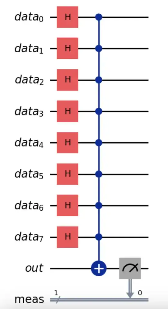

One example is that you run a circuit in a while loop until a measurement result satisfies a condition.
from qiskit import QuantumCircuit, ClassicalRegister, QuantumRegister, transpile
from qiskit_aer import AerSimulator, Aer
from qiskit.visualization import plot_histogram
from qiskit_ibm_runtime import QiskitRuntimeService
from qiskit.transpiler.preset_passmanagers import generate_preset_pass_manager
from qiskit_ibm_runtime import Session, SamplerV2 as Sampler
from qiskit.circuit.library import ZGate, XGate, RZGate
service = QiskitRuntimeService()
create a quantum circuit
num_of_qubits = 8 # 1byte is_stop = False
data_r = QuantumRegister(num_of_qubits, "data") out_r = QuantumRegister(1, "out") cr = ClassicalRegister(1, "meas") qc = QuantumCircuit(data_r, out_r, cr) qc.h(data_r) qc.append(XGate().control(num_of_qubits), list(data_r)+[out_r]) qc.measure(out_r, cr) qc.draw("mpl")
aer = AerSimulator()
pm = generate_preset_pass_manager(backend=aer, optimization_level=1)
isa_qc = pm.run(qc)
result = None
num_of_loops = 0 while(not is_stop): num_of_loops += 1 with Session(backend=aer) as session: sampler = Sampler(session=session) result = sampler.run([isa_qc], shots=1).result() pub_result = result[0] counts = pub_result.data.meas.get_counts() if '1' in counts: is_stop = True print("all qubits are 1, # of loops {}".format(num_of_loops))
all qubits are 1, # of loops 90
As far as I know, there's no such mechanism that it loops inside a quantum circuit itself. In my view, a loop would typically be used when the number of executions is unknown(or could be large), while we would use a quantum computer since we know that a calculation would be finished within a small number of times. Hence, not having a loop inside it makes sense, at least, to me.
