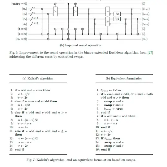

You can perform $|a\rangle|0\rangle \rightarrow |a\rangle|a^{-1}\rangle$ efficiently by using superposition masking. This uses some multiplications on the quantum computer to move the expensive computation of an inverse to a classical computer where it's much faster. But this process isn't reversible, so weirdly you can't then uncompute $|a\rangle|a^{-1}\rangle \rightarrow |a\rangle|0\rangle$ with the same technique.
I don't think that doing a modular exponentiation under superposition will be cheaper than the standard technique of doing an extended binary gcd under superposition, such as in Figure 6/7 of "Improved quantum circuits for elliptic curve discrete logarithms".
