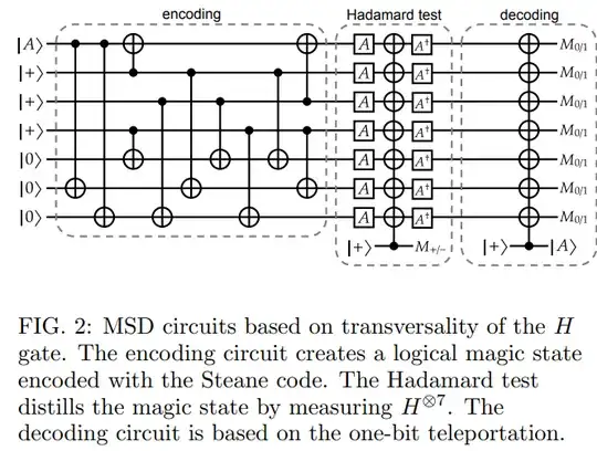

There's nothing bad about it. See "Very low overhead fault-tolerant magic state preparation using redundant ancilla encoding and flag qubits" and "Even more efficient magic state distillation by zero-level distillation".
I would say the main "bad" things about these papers are that the first used a very weird connectivity graph and required a noise strength of $10^{-4}$, while the second didn't properly consider the problem of growing the state from the initially small distance to a usable large distance.
Why does there seem to be such a strong preference for fault tolerantly preparing magic states using magic state distillation?
I'm not sure why Gottesman calls it "ugly", given that it's exactly equivalent to 15-to-1 T state distillation, just not concatenated and with the gates in a slightly different order. In the Itogawa et al paper they provide a circuit of the construction. Notice that there are exactly 15 "A"s in this circuit... (not counting the 'decoding')? You can also check that you need a Z error next to at least three of those A gates to make the full circuit fail. It's 15-to-1 distillation.
