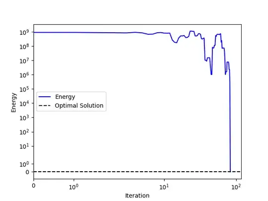

To solve this PUBO, I've tried simulated annealing and it works:

energies = np.array(energies)
return best_x, best_H, energies
p , q = 241, 251 pq = p*q L = (np.floor(np.log2(float(pq))).astype(int)) //2 + 1
B = beta(L)
x, H, energies = simulated_annealing(B, pq, n_iterations=10_000, T_start=1e-1, T_end=1e-5)
get back the values of p and q
p_o = int(''.join(map(str, x[:L])), 2) q_o = int(''.join(map(str, x[L:])), 2) print(H) print(p_o, q_o)
plt.plot(energies, color='b', linestyle='-', label='Energy') plt.yscale('symlog') plt.xscale('symlog') plt.xlabel('Iteration') plt.ylabel('Energy') plt.hlines(0,xmin=0, xmax=1.4len(energies), color='black', linestyle='--', label='Optimal Solution') plt.xlim(0, 1.4len(energies)) plt.legend(loc = 'center left') plt.show()
Note that my code assumes the same length of bits for both numbers, but as mentioned before, it can be generalized pretty easily. This code successfully factors the number 60491 to 241 and 251.
