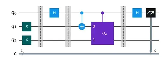

Assume that you want to estimate the value of $A_{ij}$, then you can swap $i$ and $j$ columns then use Hadamard test to estimate $\langle j| U_A |j \rangle$. The Hadamard test is able to estimate the real and imaginary parts in two separate runs.
The following code demonstrates how to do that in Qiskit.
# i and j in binary
bin_i = bin(i)[2:].zfill(num_qubits)
bin_j = bin(j)[2:].zfill(num_qubits)
h_circ = QuantumCircuit(num_qubits + 1, 1)
<j|U|j>
for index, bit in enumerate(bin_j): if bit == '1': h_circ.x(num_qubits - index) h_circ.barrier()
h_circ.h(0)
Set _imaginary = True to estimate the imaginary part
if _imaginary: h_circ.sdg(0) h_circ.barrier()
SWAP columns i, j
for m in range(num_qubits): if bin_i[m] != bin_j[m]: h_circ.cx(0, num_qubits - m)
u_circ is the quantum circuits that implemnets
h_circ.append(u_circ.to_gate(label=' $U_A$ ').control(1), range(num_qubits + 1)) h_circ.barrier() h_circ.h(0) h_circ.measure(0, 0)
The circuit should look like below for $i = 2$ and $j = 3$
