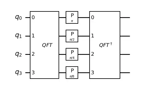

Using the fact that circulant matrices are diagonalizable by Fourier transform, and the unitary of incrementer is circulant, you can come up with the following circuit which has depth less than $16n$ for $n < 100$ and uses no ancillas
where $\text{QFT}$ is the Quantum Fourier transform and $P$ is the phase gate
$$P(\lambda) = \begin{pmatrix} 1 & 0 \\ 0 & e^{i\lambda} \end{pmatrix}$$
