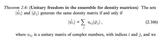

Here is a theorem from Nielsen & Chuang: the second half of the last sentence doesn't matter enter image description here
What is a good way to think about why this is true?
My reasoning:
Theorem 2.6 states that a unitary transformation, such as ‘Uij’, does not alter the quantum system's underlying properties.
Intuitively:
The unitary transformation can be viewed as a generalization of the global phase factor. It won't affect the probability of the qubit being in each state.
**However, my reasoning doesn't make sense to me because the Pauli-X gate is a unitary transformation and will change a state from |0> to |1>, so the state vector and density matrix are different for those states and all we applied was a unitary transformation, so I don't see how this theorem can say a unitary transformation is irrelevant. **
Mathematically:
When the outer product of the state vector is calculated, the unitary transformation is multiplied by its conjugate transpose to form the identity, leaving the state unchanged.
