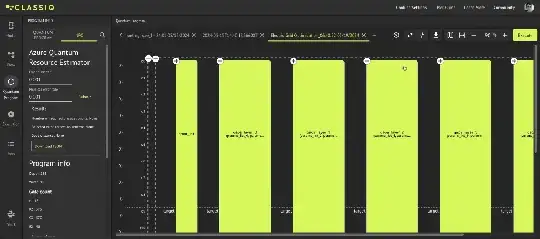

Will give this circuit in platform.classiq.io:
And this solution
x = [1, 0] , cost = 2.9999999999999964
