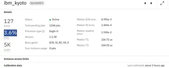

A 5-bit adder requires several dozen two-qubit gates. Current state of the art two-qubit gate error rates are between 0.1% and 1%. At the time I am writing this post, https://quantum.ibm.com/services/resources?tab=systems&system=ibm_kyoto states the error rate of ibm_kyoto is 3.6%:
If each gate has a 96.4% chance of working right, and you do 50 of them, there's a 16% chance that nothing went wrong. Thus you expect most of the answers to be wrong.
Things would not look so grim with a 0.1% error rate, but even then you will quickly run into walls. This is why quantum error correction is so crucial to running large computations.

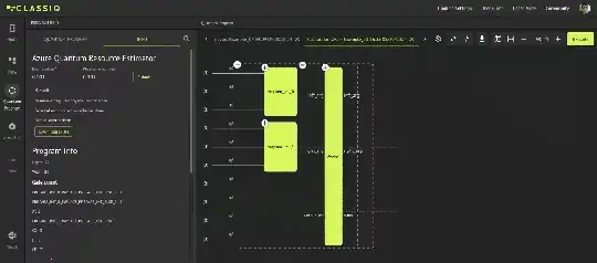

You can run experiments on different computers easily using a compiler like classiq, that chooses the relevant implementation automatically. It also chooses an implementation that suits the width limit of the hardware by automatic auxiliary usage and release
Once you define the high-level model - adder, using the classiq IDE:
qfunc main(output a: qnum, output b: qnum, output res: qnum) {
  prepare_int<4>(a);
  prepare_int<5>(b);
  res = a + b;

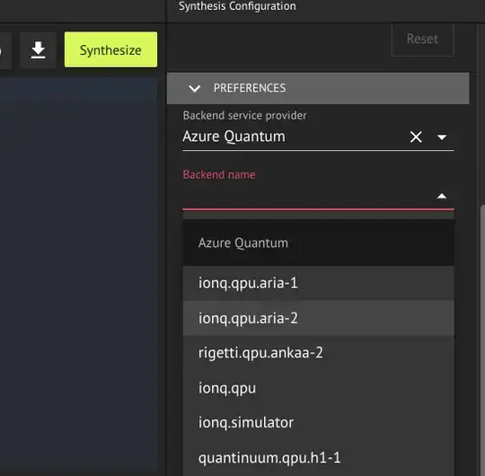

You can choose a hardware in the synthesis preferences (or your own basis gates):
Synthesize it, let the compiler choose the more fair implementation for that HW, and execute it on the hardware among the list of available backends in the execution page

Or choosing from list of backends as explained in the user guide
