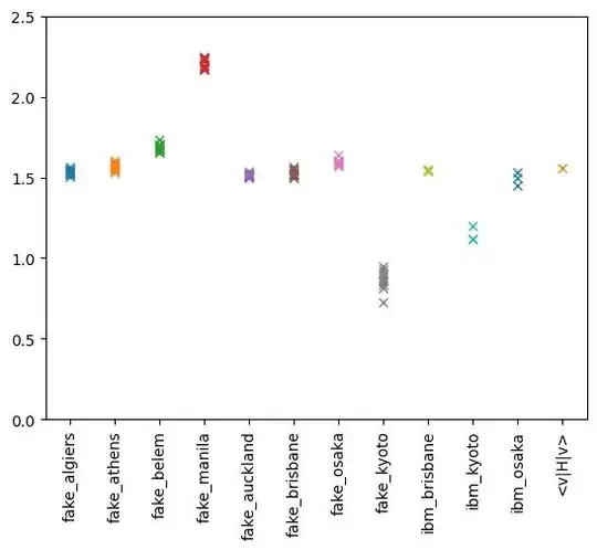

I was running the IBM qiskit sample code and noticed that the results vary on different backends. I thought it was quantum noise, so I repeated the same calculation on many different backends and got this figure:
The results are very consistent within the same backend but vary quite a bit between backends, particularly on fake_manila, fake_kyoto, and ibm_kyoto. So, the cause does not seem to be quantum noise.
BTW, The theoretical result (from matrix multiplication) is shown on the right most point as $\langle v|H|v\rangle$.
Did I do something wrong?

The problem is caused by a different type of noise each QPU suffers from. Nowadays, it is even not easy to produce two completely same qubits, not to mention two identical QPUs.
Please, have a look at calibration data in IBM Q portal. You can see that for example T1 and T2 times vary widely both for particular QPU and also among them.
These discrepancies in quality of qubits cause that one circuit runs differently on different backends.
