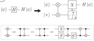

It follows the protocol for Hadamard gate injection:
Considering that $H \simeq \sqrt{Z}\sqrt{X}\sqrt{Z}$, it should be equivalent to inject $\sqrt{X}$ wrapped between $\sqrt{Z}$ gates.
I am led to think that $\sqrt{X}$ injection is possible, with some protocol that is somehow complementary to the $\sqrt{Z}$ injection.
However, I can't find it. Is it possible?

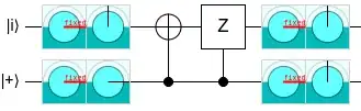

Note that you can replace $|i\rangle = |0\rangle + i|1\rangle$ with a $|+\rangle$ state followed by $\sqrt{Z}$, if needed. Also note that it's possible to duplicate $|i\rangle$ states by using RX,CX,CZ:
