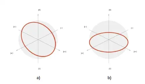

As shown in Ref, the amplitude of a pulse determines the rotation on the x-axis, while the angle determines the rotation on the z-axix. According to the paper, the author proved such results with pulse experiments and plot the results on the Bloch sphere.
Experiment results in paper
However, after reading the source code of this paper on Github. He utilized the following method to simulate pulse circuit.
