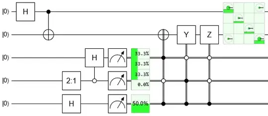

Here is the state you get from 50% depolarizing a Bell pair (the bottom three qubits are really bits being used to generate the error):

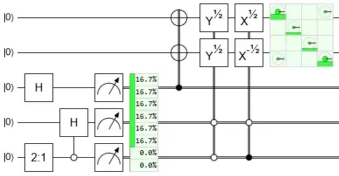

Here is the same state, but made under LOCC conditions. Alice and Bob start with two $|0\rangle$ qubits. They roll a die. If the die roll is odd, they each apply X to their qubits. Also, if it's 1 or 4, they each apply $\sqrt{Y}$ to their qubits. Also, if it's 2 or 5, Alice applies $\sqrt{X}$ to her qubit while Bob applies $\sqrt{X}^\dagger$. The density matrix of the resulting state, after tracing out the die, is identical to the depolarized Bell pair. But since no two qubit gate has occurred, we know the qubits cannot be entangled:
