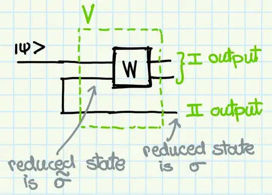

In conclusion: if $\Phi$ has two output spaces, the second one of which knows nothing about the input, then its first output must contain all information about $\rho$, however it can nonetheless be correlated with the second output, as you can see from the fact that $\Phi^c$ contains $\sigma^c$, which obviously is tightly connected to $\sigma$. This means that we cannot conclude that the dilation isometry $V$ representing the channel has the form $V=\tilde V\otimes |\phi\rangle$ for some state $|\phi\rangle$ and isometry $\tilde V$. For example, we could instead have a structure like the following:
But even if we could conclude that $V=\tilde V\otimes |\phi\rangle$, or even better that $V=U_A\otimes |\phi\rangle$ for some unitary $U_A$, we still couldn't conclude that the overall unitary $U$, the one such that $V=U(I\otimes |0\rangle)$, factorises. The reason being that $U$ could for example decompose as $U=\sum_i U^A_i\otimes |i\rangle\!\langle i|$, meaning that $U$ could have a more complex "entangling" action, which you however cannot see by fixing the initial ancilla to $|0\rangle$.
