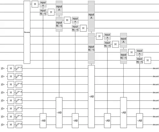

Here's an $O(n \lg^2 n)$ construction of the QFT based on merging groups of phasing operations into multiplications:
You can verify the circuit works in Quirk.
The "reverse" gate reverses the order of the qubits; it's just $n/2$ swaps. The input gates indicate where the values multiply-added into the phase gradient register come from. The [::-1] means the input is ordered with the most significant qubit at the top instead of at the bottom. The phase gradient preparation assumes you can do arbitrarily fine rotations with cost $O(1)$; everything else is done exactly with just TOFFOLI+H.
The recursive relation for the cost is $T(n) = 2T(n/2) + O(M(n))$ where $M$ is the cost of multiplication. There are horrendously inefficient multipliers with asymptotic cost $O(n \lg n)$ achieving the $O(n \lg^2 n)$ I said at the start. More practically, using a Schonhage-Strassen multiplier, this construction has cost $O(n (\lg^2 n) (\lg \lg n))$. Or, with a Karatsuba multiplier, the cost is $O(n^{\lg_2 3})$.
In practice you would never, ever use this circuit because it's dumb to pay 100x more gates for exactness when nothing is trulyexact. Even ignoring the arbitrarily fine rotations, in practice there's no such thing as an exact Toffoli or an exact Hadamard. You can make rotation error arbitrarily small, but you can't make it 0. Everything is already approximate, so just use the much cheaper approximate QFT.
This specific construction is from two blog posts. The general idea was first found in "Fast parallel circuits for the quantum Fourier transform".
