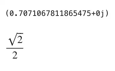

The expectation value can be calculated in a straightforward way using Statevector.expectation_value like this:
from qiskit import QuantumCircuit
from qiskit.quantum_info import Operator, Statevector
from sympy import nsimplify
testCircuit = QuantumCircuit(1) testCircuit.h(0) H = Operator(testCircuit) # define the operator
ket_0 = Statevector.from_label('0') # define the vector expectation_value = ket_0.expectation_value(H) # calculate the expectation value
print(expectation_value) display(nsimplify(expectation_value)) # display an exact answer if the decimal expression is recognized
