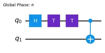

Solovay-Kitaev algorithm is implemented in SolovayKitaev class. You can use it by transpiling your circuit using
basis_gates = ["u", "cx"]
Then run SolovayKitaev on the transpiled circuit:
from qiskit.transpiler.passes.synthesis import SolovayKitaev
skd = SolovayKitaev() discretized = skd(qc_transpiled)
The result will be
Note: according to the documentation, SolovayKitaevSynthesis is invoked by transpile() method when the unitary_synthesis_method parameter is set to "sk". However, it didn't work with me.
