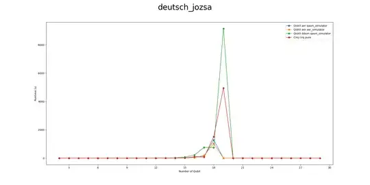

I have tried to make the implementations so that a fair comparison can be made. All the executions were done on a personal computer with 16GB RAM and normal CPU. The expected output was that as the number of qubits increased, the execution time increased linearly or exponentially, but the graph I obtained after averaging 5 different executions for each simulator, shows a strange behavior! Here it is: Deutsch-Jozsa Runtime by Number of Qubits
What is the problem?! Is there an implementation error on my part?!
