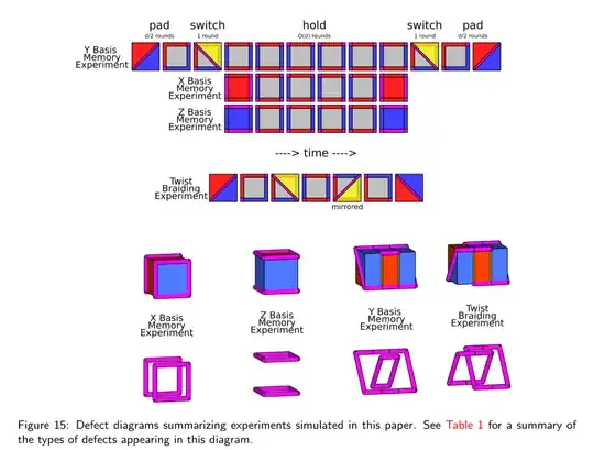

Q2: As seen in Figure 15, what types of questions can be answered / what is the workflow for this defect diagram? enter image description here

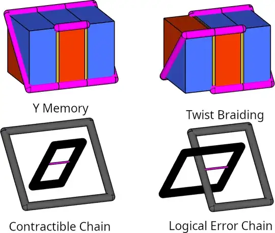

This figure is intended to be an overview of the various simulations that were done in the paper. It's not really supposed to surprise you with new answers, but rather to present an interesting perspective on what was done. When I look at it I see examples of step-by-step defect diagrams creating different shapes in spacetime, and a demonstration of how variations that look innocuous in the moment (like mirroring) can have important topological implications in spacetime (like linking rings, creating a logical error mechanism).
