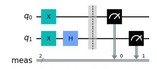

I have QC like this

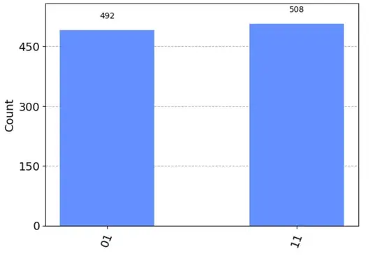

The final state before measure should be $|1⟩ ⊗ |-⟩$, and it will be $\frac{1}{\sqrt{2}}(|10⟩ - |11⟩)$, so the probability of this QC should be a half is $|10⟩$ and other half is $|11⟩$. But the result of this QC is a half is $|01⟩$ and other half is $|11⟩$.
Can someone explain me why? The script is down below.

compiled_circuit = transpile(circuit, simulator) job = simulator.run(compiled_circuit, shots = 1000) result = job.result() counts = result.get_counts(circuit) plot_histogram(counts)
print(counts)

Could it be that states are labeled from right to left? Try the H gate on q0 and see if the labeling reverses.
