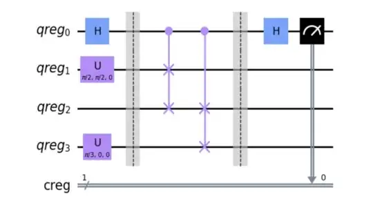

Circuit for m = 3 (The gates to the left of the dotted line for qreg 1-3 are just to set up sample quantum states to test the circuit on): enter image description here

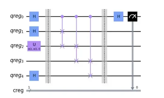

Circuit for m = 4 (The gates to the left of the dotted line for qreg 1-4 are just to set up sample quantum states to test the circuit on): enter image description here
