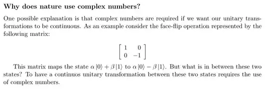

Context. Scott Aaronson, lecture 2, course 6.896 Quantum Complexity Theory, september 2008 says that a matrix such as $$\begin{bmatrix}1&0\\0&-1\end{bmatrix}$$ maps the state $\alpha|0\rangle + \beta|1\rangle$ to $\alpha|0\rangle - \beta|1\rangle$.
He then asks
What is in between these two states? To have a continuous unitary transformation between these two states requires the use of complex numbers.
Question. Could you elaborate this conclusion with an example? I can't quite see the deduction. I can see why we want it to be continuous: the Schrödinger equation is a differential equation with respect to time, which therefore requires time to be continuous. So if that matrix maps a state into another one, we may ask what happened in between the change of state. And how does that require complex numbers?
Source: enter image description here
