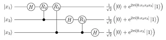

I have the exercise to implement the Inverse QFT with Qiskit for any number of qubits without the swapping part. I tried to implement something like this for any $n$. https://en.wikipedia.org/wiki/Quantum_Fourier_transform
Now I got this code but it doesn't work and I'm kinda lost because I do not know if it's a mistake of the controlled Z-rotation (which we have to do using only Single Qubit Gates and CNOT) or if I misunderstood the inverse Fourier transformation and have to do something else.
