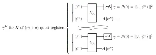

My question is motivated by the following construction (see the circuit below). Imagine that one needs to do Grover / AA on $K$ parallel registers. If the success probability is $\gamma$ for each register, the total success probability is $\gamma^K$, which is not scalable with $K$ (assuming that the number of qubits $m+n$ in each register is fixed), unless there is a way to make $\gamma$ itself exponentially close to $1$.
Note that if $A$ is unitary (as in the case of using QSP for simulating time evolution), then one can indeed make $\gamma$ exponentially small at a cost polylogarithmic in problem parameters. However, for $A$ being non-unitary one would need to first somehow amplify each $\gamma$.
