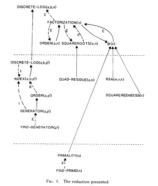

It's an interesting question to pose which problems reduce to factoring (or discrete log), and whether any of those problems could be of practical value. In general I think the consensus is that most such problems are of some number-theoretical bent in the first place.
There's a 1987 paper from Heather Wolf that proves and lists some reductions known at that time:
Fig. 1 of Wolf
Whether any other reductions are known, since, say, Shor '94, that are of industrial relevance, I am not sure. I've often thought about reducing factoring to finding Golomb rulers but I don't know enough number theory to make headway.
