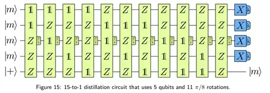

I consider the 15-to-1 distillation protocol, which circuit is represented below.
Basically, by using $15$ magic states of probability of error $p$, we can, upon post-selection, create a magic state of probability of error $35p^3$. Here, $15$ should be read as $4+11$, where $4$ represents the magic state on the left of this image, and $11$ are the magic states used to implement each of the $11$ $T$-gates in yellow (see for instance this post to understand how these $T$ gates are implemented with the magic state).

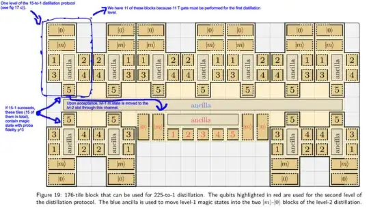

In practice, going from $p \to 35p^3$ might not be enough to run the algorithm we like (the error rate might still be too high). Hence, we can re-iterate the process and take $15$ purified magic states (error $35p^3$) to create $1$ magic state of error proba $35(35p^3)^3$. It can be done through with the layout below, which I comment afterwards.
The blue circle on the upper left represent the tiles implementing the circuit on Fig 15 (the exact way the protocol is done can be seen on Fig 17c)) in Litinsky's paper. The tile "5" is where the purified magic state (error proba $35p^3$) is located. Then, we move it to the red slot. The tiles in red perform the second level of distillation (putting the error to $35(35p^3)^3$).
Overall, because it takes $11$ timesteps to create a level-1 magic state, and we have $11$ level-1 magic state distillation blocks (look at fig 19), assuming the level-1 magic states are always accepted, we will have one level-1 magic state ready each timestep.
The level-2 magic state requires $11+4$ level-1 magic states, so it can be completed in $15$ timesteps.
