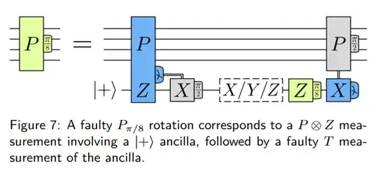

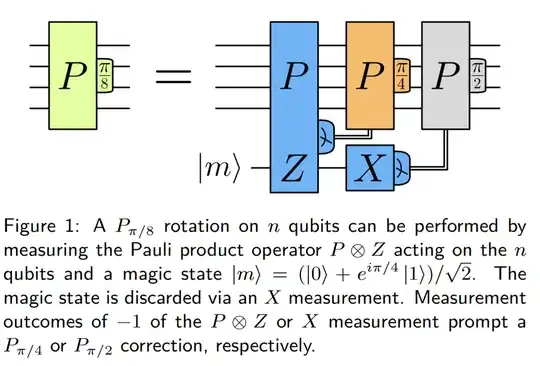

The following circuits from Litinski's Magic State Distillation paper are two ways to consume magic states. Why do these circuits work? I've heard there's a relationship with the Choi-Jamiolkowski isomorphism but can't understand the relationship.
Magic state consumption
Fault-T measurement based

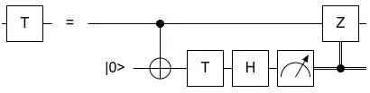

You can pick $\theta=1/4$ to get a T gate. And because the bottom qubit is being discarded, you can do whatever you want with it without affecting the equality, such as doing a Hadamard and then measuring because why not:
You can then commute the CX through the H turning the CX into a CZ, and apply the deferred measurement principle to get it past the measurement:

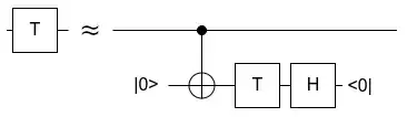

Now we're going to use a type of analysis I call "getting the case where all measurements return False to do the right thing, and then fixing the rest later". This is also sometimes called "the ZX calculus" in more specialized contexts. Basically we replace measurement with postselection so we can analyze one case instead of all cases.
Anyways, define the symbol $\approx$ to mean "equal assuming all measurements return False". To avoid confusing measurement and postselection I will draw a measurement-assumed-to-return-False as "<0|". The identity above then simplifies, because the feedback only mattered in the case where the measurement returned True:
We can now fold the T and H into the measurement to produce a T basis postselection "<T|":

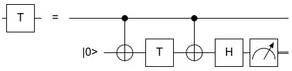

One of the great things about this kind of analysis is that postselection is the time reverse of preparation. We can mirror the circuit and still get the same result:
Turning the postselection back into a measurement, we have to check what's going on in the case where the output is True instead of False. It turns out that now the output is off by an S gate, instead of a Z gate, so we throw that in:
You can turn this basic circuit into the one from Daniel's paper by generalizing $Z^\theta$ into $P^\theta$ where $P$ is a product of Paulis instead of a single qubit's Z axis. Also you need to rewrite the S gate onto an ancilla in the same way we just rewrite the T gate onto an ancilla, and rearrange that a bit, in order to end up at the way he's doing the fixup.
