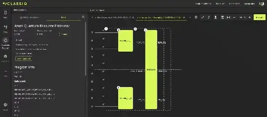

You can use the classiq compiler with the following code from this git repo. Also, using different optimization parameters for the compiler will automatically choose the implementation. Regarding the representation of the sign, once the variable is defined as a signed number using QNum[3, True, 1] (True for signed number) you can use the executor to interpret it correctly.
Here is an example:
from classiq import *
@qfunc def main(a: Output[QNum[3, True,2]], b: Output[QNum[4,False,1]], res: Output[QNum]) -> None: allocate(3, a) allocate(4, b) hadamard_transform(a) hadamard_transform(b)
res |= a-b
qmod = create_model(main) qprog = synthesize(qmod) show(qprog)
job = execute(qprog) result = job.result()[0].value print(result.parsed_counts)
job.open_in_ide()
You can see how to interpret the results in the IDE at platform.classiq.io or in Python according to the answer here
If you need the qiskit circuit object of, use this command to get the QASM:
QuantumProgram.parse_raw(qprog).transpiled_circuit.qasm
And convert it with the answer here

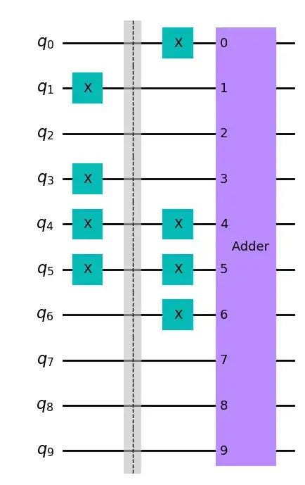

A full-adder circuit can be used for subtraction by using the fact that: $$a - b = a + \neg b + 1$$ So, you need to invert the subtrahend, increment it by one, then do the addition as usual. As an example, the following code uses VBERippleCarryAdder to subtract 3 from 5:
from qiskit import QuantumCircuit
from qiskit.circuit.library import VBERippleCarryAdder
num_state_qubits = 3 adder = VBERippleCarryAdder(num_state_qubits, name=' Adder ') num_qubits = len(adder.qubits)
circ = QuantumCircuit(num_qubits)
Five
circ.x([1, 3])
Three
circ.x([num_state_qubits + 1, num_state_qubits + 2])
circ.barrier()
Subtraction:
1) invert b:
circ.x(range(num_state_qubits + 1, 2 * num_state_qubits + 1))
2) add one (using carry-in)
circ.x(0)
3) do the addition
circ.append(adder, range(num_qubits))
circ.draw('mpl')
If you run this circuit the output will be: $001{\color{red}0\color{red}1\color{red}0}1011$
