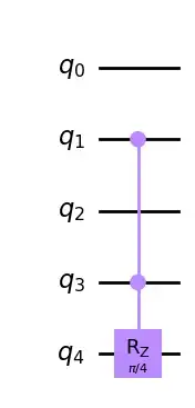

circ = QuantumCircuit(5) circ.append(gate.control(2), [1, 3, 4]) circ.draw('mpl')
The result: enter image description here
