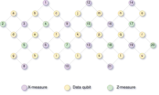

Initial state with two patches and a column of uninitialized data qubits
The figure above shows the initial condition for two d=3 patches (rotated) before a lattice surgery merge operation.
Next, as soon as a merge operation starts, the combined patch looks like the figure below:
Merged patch
A few questions up till this point:
  • Are X-measure qubits 10 and 12 needed at all? Or can I get away by ignoring them?
  • Data qubits j, k, l will be initialized in the Z-basis since it's the basis of the lattice surgery. Consequently, in Stim, the detector annotations for X-measure qubits 9, 10, 12, 13 will not be included in the first round of the merge operation?
  • The Z-measure qubits 7, 15 are changing from 2-body operators to 4-body operators, but the corresponding detector annotations will keep comparing the measurement in the first round after the merge operation with the measurement just prior to merge?
  • Will the two qubits be considered merged after d rounds of syndrome measurements? What would the logical observable now be for Stim?
Next, suppose I want to perform a split operation on the same merged patch. This would involve measuring the intermediate data qubits j, k, l:
  • The intermediate qubits will be measured in the basis of the lattice surgery (Z) and then used in the detector annotations of the Z-measure qubits 7 and 15? More specifically, if the measurement records for the intermediate qubits are rec[-5] rec[-6] rec[-7] and the measurement records for qubits 7 and 15 just before the split are rec[-8] rec[-9] (for simplicity), the detector annotation for qubits 7 and 15 in the first round of the split operation would be (assuming rec[-1] rec[-2] are the most recent measurements for qubits 7 and 15:
DETECTOR(Qubit 7) rec[-1] rec[-8] rec[-5] rec[-6] rec[-7]
DETECTOR(Qubit 15) rec[-2] rec[-9] rec[-5] rec[-6] rec[-7]
