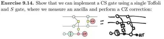

This is assuming you're okay with mid circuit measurement and reset. Then you can deterministically implement the CS gate with the following 3 qubit Clifford+Toffoli circuit (from the legitly free to read online Picturing Quantum Software textbook at https://github.com/zxcalc/book) enter image description here This textbook circuit classically conditions the CZ on the outcome of that mid-circuit single qubit measurement. Another option is I drew how to do it without feedforward by instead doing one more CCZ gate.
Then if I understood the paper at https://www.nature.com/articles/s41534-021-00424-z, you can approximate any 2 qubit unitary by a 2 qubit Clifford+CS circuit, and from our circuit above that is deterministically implementable as a 3 qubit Clifford+Toffoli circuit. This includes 2 qubit unitaries of the form any single qubit unitary tensor identity, so you can approximate any single qubit unitary with an irrelevant borrowed ancilla - it is irrelevant because you need 3 qubits to do a Toffoli in the first place. So you can then approximate any n qubit unitary where n >= 3 with an n qubit Clifford+Toffoli circuit where mid circuit measurement and reset are allowed. The easiest argument for this is because you can approximate Clifford + any non-Clifford single qubit unitary such as T without ancilla.
