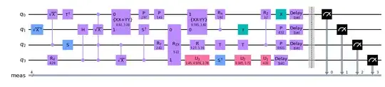

Let's first create a sample circuit that contains measurements and delays:
from qiskit.circuit.random import random_circuit
circ = random_circuit(4, 10) circ.delay(1) circ.measure_all()

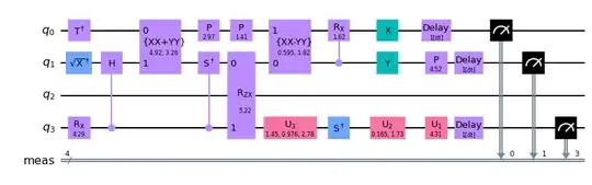

Now, remove all instructions for one of the qubits
qubit_index = 2
qubit = circ.qbit_argument_conversion(qubit_index)[0]
for idx, _instruction in reversed(list(enumerate(circ.data))): for _qubit in _instruction.qubits: if _qubit == qubit: del circ.data[idx]
The result:
