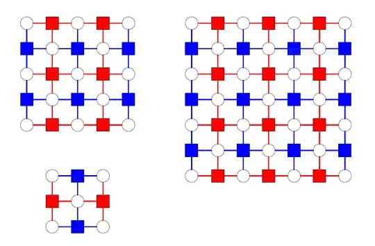

A $[[5,1,2]]$ code occurs as a member of a family of hypergraph product codes with parameters $[[2d^2-2d+1,1,d]]$ codes : $[[5,1,2]],[[13,1,3]],[[25,1,4]],\cdots$. These are all CSS codes. Here are (quantum) tanner graphs of the first three :enter image description here
