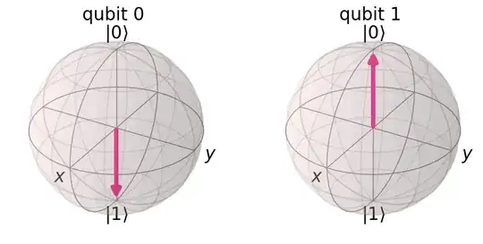

I apply a x-gate to qubit0 first, then apply a cx-gate. enter image description here
After running this code, qubit1 haven't be flipped. The result have shown that qubit0 is target-q and qubit1 is control-q. That is beyond comprehension!! enter image description here
What make me confused is why qubit0 isn't control-qubit in code circuit.append(gatecx,[0,1])?

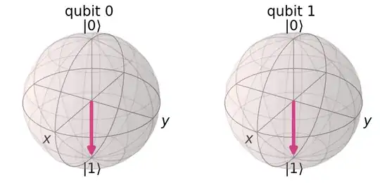

Then I swapped the position of 0 and 1, circuit.append(gatecx,[1,0]), qubit1 was flipped. Is the first position a control qubit? enter image description here
Telore
This is because Qiskit uses little endian bit ordering. See the details here.
So, in your code should define matrix1 as follows:
matrix1 = [
    [1, 0, 0, 0],
    [0, 0, 0, 1],
    [0, 0, 1, 0],
    [0, 1, 0, 0]
You may also use the fact that Qiskit saves matrix representation in the gate to define matrix1
from qiskit.circuit.library import CXGate
matrix1 = CXGate().to_matrix()
