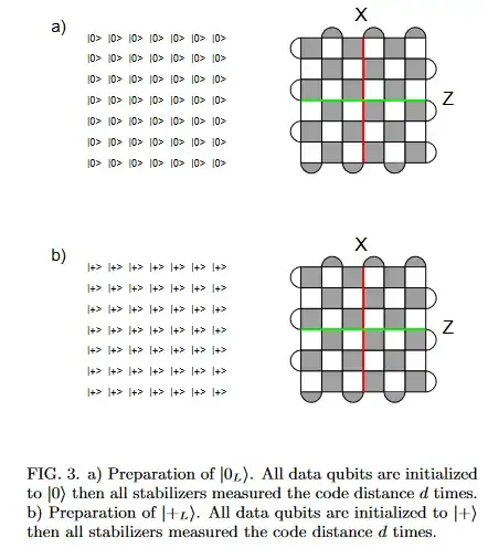

Extra question, how do you even prepare an eigenstate of these operators, i.e. $|0\rangle_L, |1\rangle_L, |+\rangle_L, |-\rangle_L$ to begin with?
$X_L$ and $Z_L$ observables are prepared and measured transversally. To prepare $|+\rangle$, initialize every data qubit in the patch into $|+\rangle$. To measure $Z_L$, measure every data qubit in the patch in the Z basis.
$Y_L$ is prepared and measured by moving corner twists within the patch.
$|T\rangle$ is prepared by distillation.
Arbitrary signle qubit states are prepared by approximate decomposition into a series of H and T gates.
