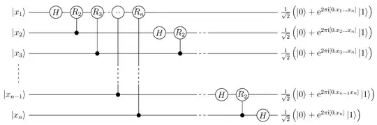

I'm not sure how you've heard about the quantum fourier transform without also seeing the circuit for it, but the wikipedia article on quantum fourier transform includes a simple quantum fourier transform circuit with polynomial gate count:
The title of your question suggests you're looking for a constant depth circuit, but I'm not aware of any constant depth circuit for the QFT. There are log depth circuits, though.
