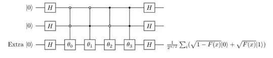

For each state $x$, I compute $v = F(x)$. So if my state vector is $[0.1026, 0.2052, 0.3078, 0.9234]$ then I compute, for example, $F(0) = v = 0.1026$. I rotate an ancilla via $2 R_y(\arcsin(v))$. So far, so good.
The next step is confusing. How do I apply the controlled rotation of the extra qubit? Just having something like a Controlled-Not from the ancilla to the extra qubit will not work and just leave the state in an equal superposition. But even have a fully controlled rotation, controlled by the bit patterns of $x$ doesn't seem to be working?

Self-answer: This is actually a bit simpler than I thought. For two qubits (and this can be easily generalized to more qubits), the circuit would have to look like the following, where the $\theta_i$ corresponding to the results of calls to $F(x_i)$ as $\theta_i = 2 \arcsin(F(x_i))$: enter image description here
With this circuit one can estimate the mean (of the $F(x_i)$) by measuring the probability of the extra qubit to be in state $|1\rangle$. Expressing the circuit as a single big-matrix operator would allow amplitude estimation to find the same results.
I've put a working version in Python (here).
