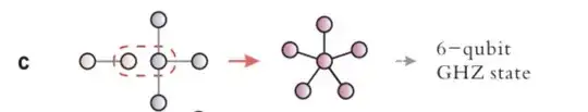

But then, when I wanted to draw a GHZ state and check on the litterature whether or not I got it right, it seemed as a lot of representations I came across of GHZ graph state were simply star graph state :

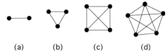

and I would have expected something like the following instead, especially because GHZ state are supposed to be maximally entangled state :

The complete graph
The complete graph is local Clifford equivalent to the star graph. One can show this by showing that, starting from the star graph around node $1$, applying the operation $\sqrt{X_{1}} \sqrt{Z_{2,\dots,n}}$ (i.e. a $\sqrt{X}$ on the first qubit, and $\sqrt{Z}$ on all other qubits) results in the graph state of the complete graph. However, actually performing this calculation is quite tedious.
Our life is made easier by the fact that the star and complete graph are related by a local complementation: a local complementation on the middle node in the star graph, results in the complete graph. Following the same paper I already linked, a local complementation on a graph is associated with a certain local Clifford operation on the graph state. Thus, since the star graph and the complete graph are related by a local complementation $\tau_{1}$, their associated graph states are related by a local Clifford operation (namely, the one I mentioned before).
Conclusion
So, in conclusion: The GHZ state, while not technically a graph state, is local equivalent to certain graph states: the star graph, and the complete graph. Note that the local complementation is invertible. Thus, if I locally complement on any other node (starting from the complete graph), I get a star graph around another middle node. All these graph states are locally equivalent to the GHZ state.
In my experience people associate both the star and the complete graph equally often with the GHZ state. Moreover, people might say the GHZ state 'is' the star graph or 'is' the complete graph, but this is technically not complete correct. However, in the study of quantum networks, these local operations don't really matter that much, and its easier to just work with graph states.
